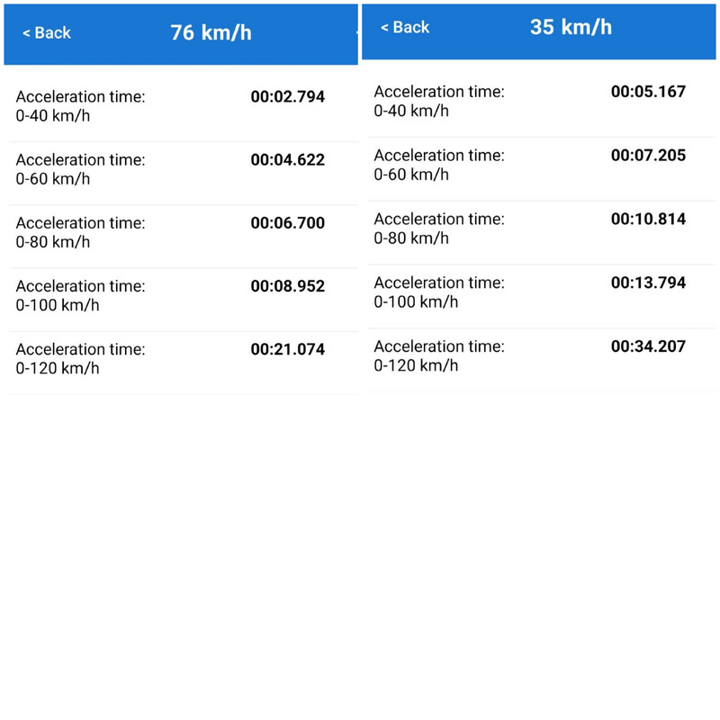

just driving with errors for now as with catalyst removing more errors came up from O2 sensors naturally so no avoiding those until i put new catalysts there. but with errors i loose TC there too, but its better then deleting errors and then drive very slugish car.
after errors comes back like cyl 2,3,5 missifres and too rish fuel mix , after it gets those errors car starts to drive ok again like launch ok overtakes ok and such, so it needs be on errors to perform, kinda weird thing but i guess its no other way now to do it. at least slugishness goes away with errors.
and those tires so used now that they just good on good roads , but out there they just dont have almost any grip if its slippery they just dont have what it takes, its fine until its dry and soft ground but moment they start slip its gone. need new tires and do more tests, maybe test those loud muds with some other guys so i could compare at last my car against others. its weird to say after so long time i still didint tested this car like just 2-3 cars and you compare then how one goes and another goes and its no problem if you stuck as other car will help you. its all because my car is never in good shape without errors now . but i would do it now with all those errors still. i just wann know how bad it is or good.
so with errors car drives like that , then i delete errors and it becomes some poor thing , bad launching , then when errors comes back its again drives and lauches fine as in first column. though with all errors like 2,3,5 cyl missifres, too rich fuel mix, bad catalyst stuff errors too because no catalysts there.
