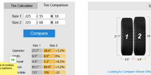

I cannot comment on fit for a 2018 but for off-road I would go standard or narrower width and taller aspect e.g. from here: Tire Size Calculator | https://tiresize.com/calculator/
or (if it will clear)
