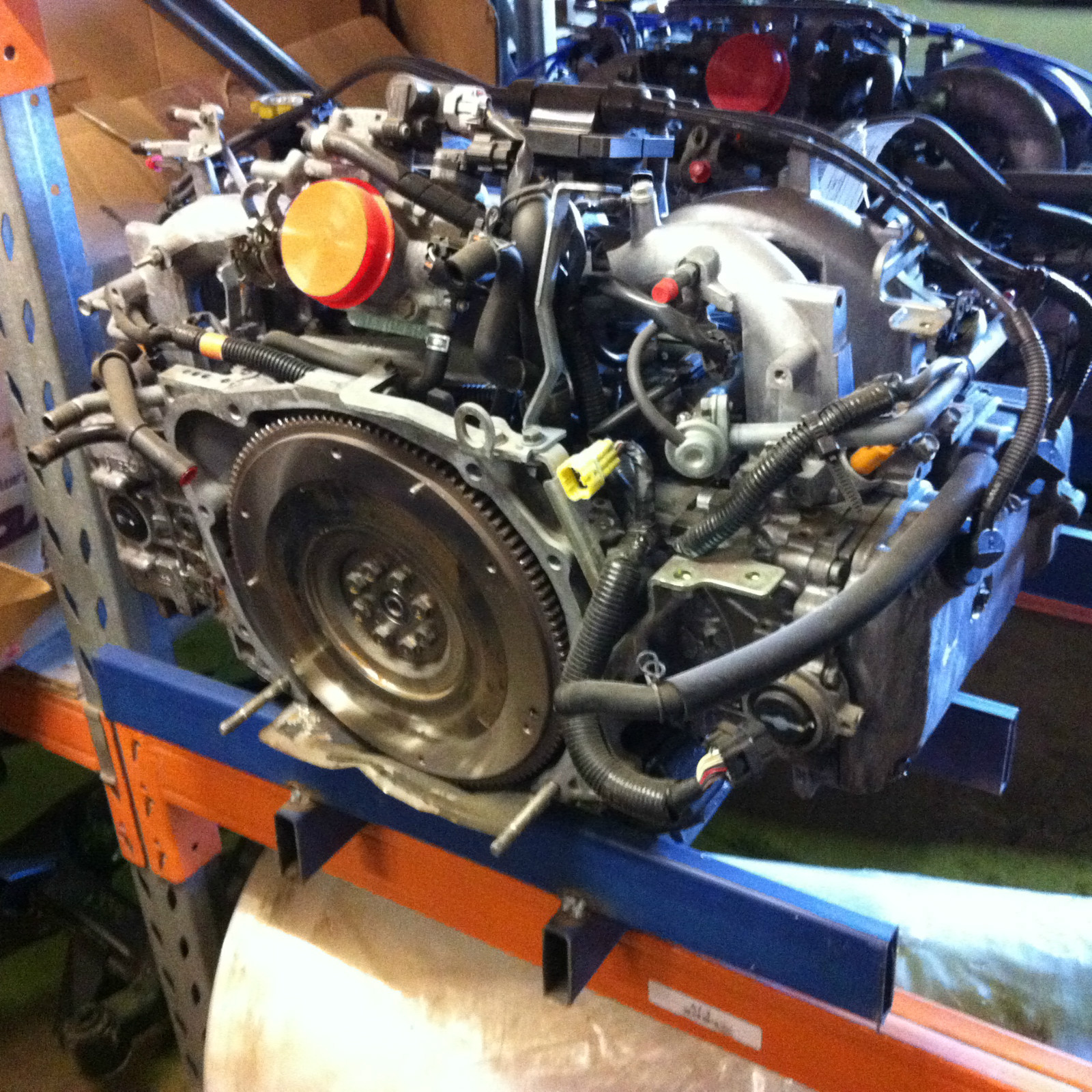

It is more caused by water coming in through the bottom of the bell housing and there is a large hole there with an exposed spinning starter gear which just sucks water mud and what ever else in.

Are you talking about the bottom inspection port or the top timing one. You can get a sealed cover for the top one but the bottom one I dont think you can.
Here is an engine without the bottom cover fitted
and here is and engine with it fitted
However this cover is not a water tight seal and still has a big hole with just the teeth of the fly wheel exposed which pump water in.

Yeah I think thats the cover but I didnt realise it still had a hole in it. I knew its not water tight, I can just barely see mine next to the crossmember & its had crap flushing out.
That was the only thing I could think of why I dont get ANY clutch slip even when repeatedly using the clutch while its under. Even when it had been submersed for ~5min I had to depress the clutch to drive out & still no slip
I have blocked the bottom hole on mine now so it is better. This was as much to try keep crap out of the starter motor as anything (hasnt worked)
