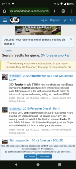

Yes I've tried to search feature and this is what I got see. Screen shot so yea no help

Kevin see my very first post before I even posted I searched and that's what the search showed screen shot attached, nothing came up maybe a dodgy search setup if there's plenty info
