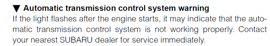

2001 Forester but believe trans is 02 or later.
AT oil temp light started flashing,constant flash no code and it does it from cold start.
Runs and drives fine.
From searching I found little info,found one vid of another doing the same thing,it was a bad solenoid.
I changed all the solenoids and yes I found a bad one.
Still runs and drives fine,still constant flashing.
I'm outta ideas and need suggestions.
Thanks.
