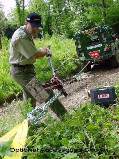

those are crap ... i have one for estimated 4tones even .. and what happens first time i tried to pull out my car ... it broke.. i mean steel cable got loose from where it was like tighten ... .anyways i recovered my car there with lifting it up .... not with pulling it .... first think .. and think more ... just then act .... in most situations its lifting a car up ...
i mean those things can pull sure ... but its like it can help in situation when you on something slippery and cant get forward,,, not when you stuck in mud ...noooo then they wont help ... just lifting your car from trouble will help... and hi lift jack ... i would say hi lift jack would pull same then this and even more ....
i mean that pure old school pull power ... plus it can lift a car too
