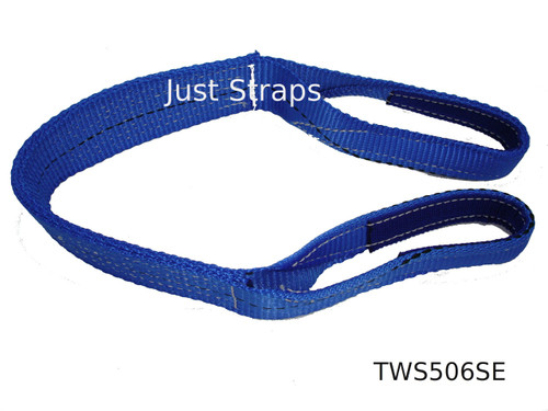

You could probably use some axle straps to attach to the lower arms etc - may be kinder to the metal. I carry a pair just in case:
They are very strong; in combination with my tree trunk protector I've pulled some fairly sizable stumps out of the ground (with the Triton in low range 4WD). 1,500kg L.C.Lashing Capacity
That's a good idea! I will look into these, as well.
