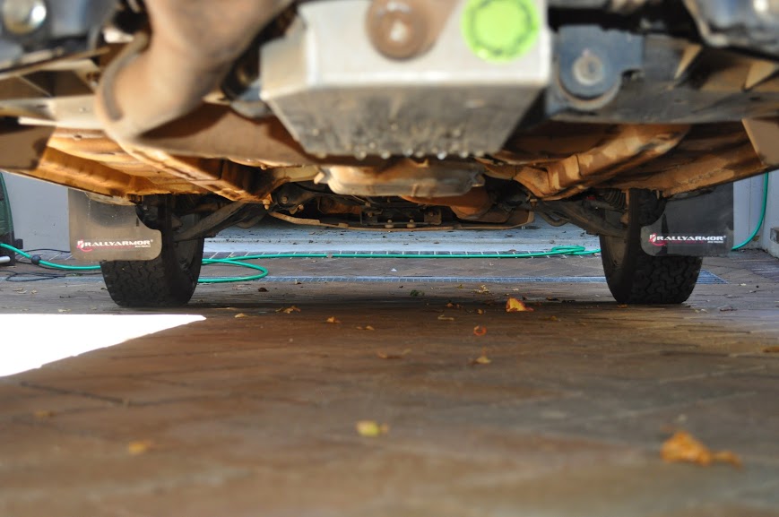

Here is my 2010 forester, don't know how it compares to the outback. I have subaxtreme cast sump guard and a primitive rear diff guard. The rear diff guard, exhaust resonator and front bashplate are basically all at the same level.
My rear guard has been used well!(That's water at the back of it)
And suprise booty shot.
Great many thanks, Almostunseen,
This will surely help somebody with a Foz!
