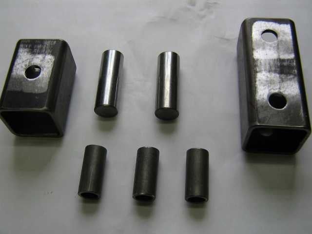

Does anyone have a pic and/or dimensions of the block that is added to the rear trailing arm body attachment point from, say, an SF body lift kit? (I assume there is such a block) I think it just a rectangular block with 2 holes drilled through it - but am not sure.
I would very much appreciate posted here or emailed to me at kevin@subaruforester.org
My car goes in on Monday for some adjustments to the rear suspension.

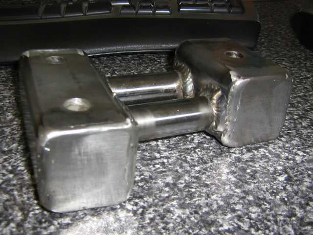

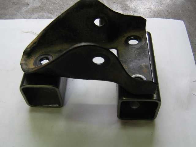

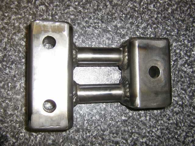

The Wholesale Suspension guys are building blocks for me - I should get pics as they make progress. The block needs to be stepped.
I think these may be of interest to all who are lifted as it will push the rear wheels back towards the centre of the wheel arch and realign the vertical position of the strut.
It's a beautiful thing!
The Wholesale Suspension guys are at it again! Love their work. Here are progress pics:

My aim is not larger tyres as I'm very happy with the 21575R15's. It's to drop the front of the rear trailing arm to counter the strut lift and so push the strut back to its natural position and also give more clearance between the tyre and front of the rear wheel arch.
I've got the car back and I'm very pleased with how the strut now sits and the wheel has moved back about 10mm. The car is sitting about 15mm higher in the rear; I'll measure & get pics on the weekend.
